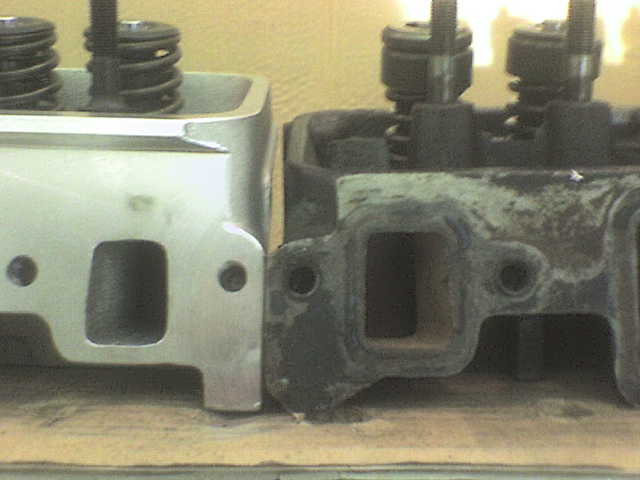

AYANT
AUSSI RECUS DES NOUVELLES CULASSES ALU ........... JE PREND LES COTES
POUR POUVOIR PROCEDER AU RETAILLAGE DES CONDUITS D'AIR ....
VOICI AUSSI LA COMPARAISON AVEC DES CULASSES STOCK .........

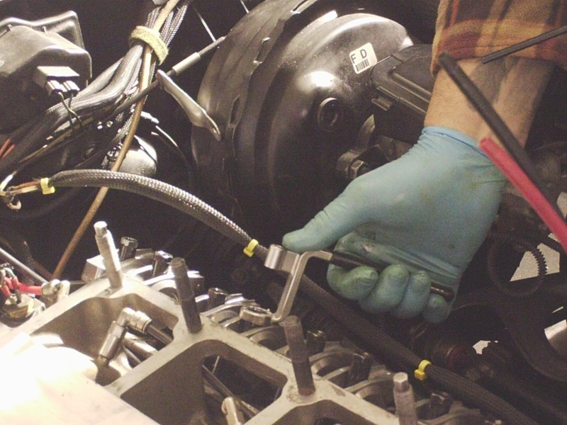

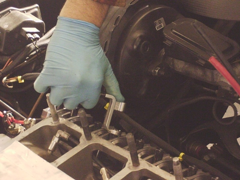

POUR
LA SUITE JE PASSE AU REMONTAGE DES CULASSES .... ET COMME CELLES CI
SONT MONTEES AVEC DES GOUJONS ........ JE ME HEURTE A UN AUTRE PROBLEME
.......... LES BASCULEURS VIENNENT TOUCHER LES BOULONS DE FIXATION
IL FAUT DONC PASSER A LA RETAILLLE DE SES DERNIERS ............
PUIS

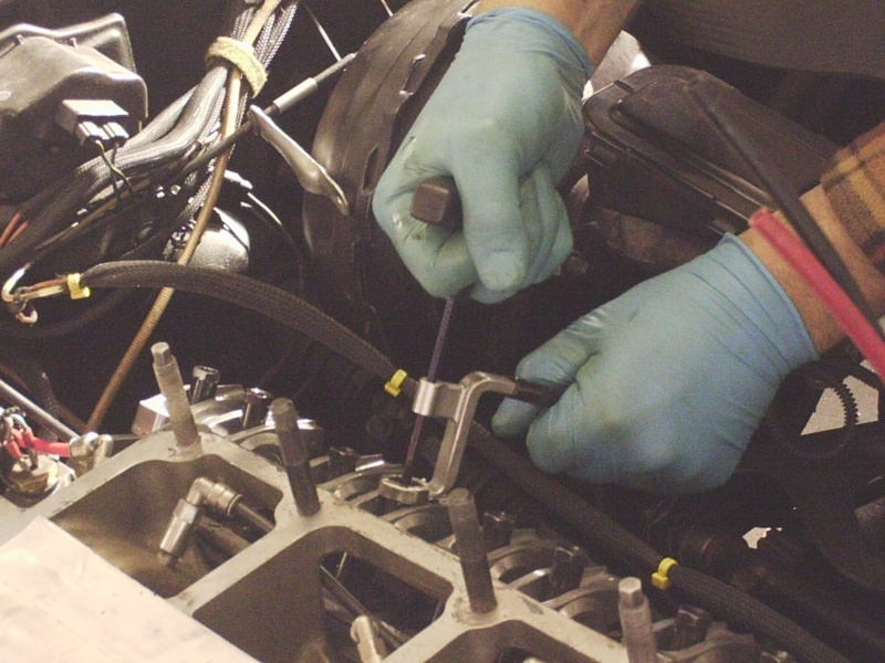

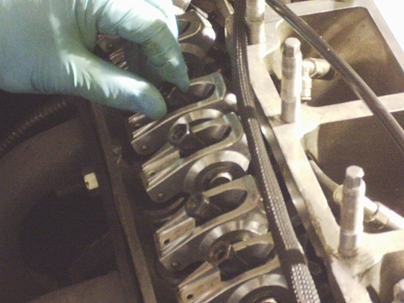

VIENT LE MONTAGE DES TIGES DE POUSSOIR ........... ATTENTION ....... A
PARTIR DU MOMENT OU VOUS MONTEZ DES POUSSOIRS A ROULEAUX VOUS DEVEZ
MONTER DES TIGES PLUS COURTES .......... NE VOUS TROMPEZ PAS DANS LES
MESURES .......
MONTAGE DE LA DISTRIBUTION PAR CASCADE DE PINION ........
A
PARTIR DE CE MOMENT VOUS POUVEZ FAIRE UN PREMIER REGLAGE DE CULBUTEURS
........ TOUT EN SERRANT VOUS FAITES TOURNER LA TIGE ENTRE VOS DOIGTS
....... QUAND CELLE CI COMMENCE A RESISTER VOUS FINISSEZ AVEC UN DEMI
TOUR ...... PUIS VOUS BLOQUEZ L'ENSEMBLE .......

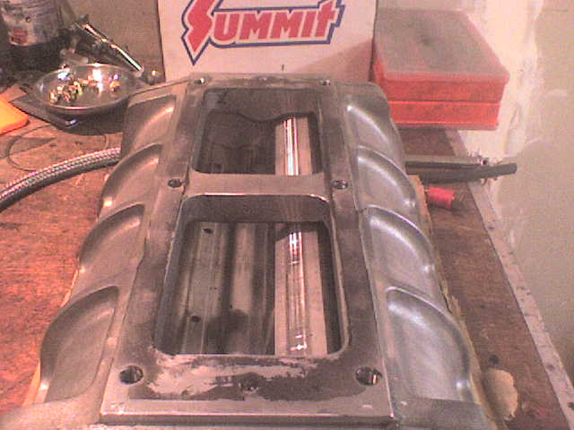

RESTE PLUS QU'A POSER LA PIECE MAITRESSE ........ "L'ADMISSION FORCEE" WEIAND 6.71 ..........

SALUT A TOUS ................. DEMAIN UNE PETITE JOURNEE DE REPOS
........... MAIS CE SOIR JUSTE UN PETIT REGLAGE
LES CULBUTEURS SONT REMONTES ..... JE PEUT DONC FAIRE UN PREMIER CALAGE
................J'APPROCHE D'ABORD A LA MAIN MES VIS POUR METTRE EN
CONTACT LES TIGES DE POUSSOIRS .......... IL FAUT QUE CES TIGES
COMMENCENT A RESISTER SOUS LES DOIGTS
ENSUITE JE SERT LES VIS DE CULBUTEURS D'UN DEMI TOUR AVANT DE LES
BLOQUEES ..............>>>>>>>>
TOUS LES CYLINDRES SONT FAIT DANS LES REGLES ..........."METTRE EN
BASCULE UN CYLINDRE ET REGLER SON OPPOSE" ............ VOILA ...........
VOUS EN SAVEZ AUTANT QUE MOI .................... C'EST A VOUS DE JOUER
MAINTENANT ......>>>>>>>

JE REMONTE LE COMPRESSEUR SUR LE MOTEUR ............ VOICI UNE DES
MANIERES DE PROCEDER ........>>>>>>>>>
J'AIS FAIT FABRIQUER PAR UN AMIS UNE PIECE D'ETANCHEITE ........ JE
L'AIS RECUPERER DERNIEREMENT ...>>>>>>>>
CETTE DERNIERE VAS ETRE FIXEE SUR LE COMPRESSEUR BOULONNE A SA PLACE
AVEC TOUS LES JOINTS ........ JE VAIS ENVOYER DE L'AIR DEDANS ET AINSI
VERIFIER L'ETANCHEITE DU MOTEUR
AVEC LA PRESSION ........ JE TROUVE UNE FUITE D'AIR ASSEZ IMPORTANTE AU
NIVEAU ARRIERE DU BLOWER .......... ET DANS LE DOUTE D'UNE ETANCHEITE
COMPLETE A CET ENDROIT JE DECIDE DE MONTER MON DEUXIEME BLOWER QUI LUI
N'A SUBIT AUCUNS DOMMAGE
LE TEST EST CONCLUANT ............. IL N'Y AS PAS DE FUITE SUR CELUI CI
................... ALORS DEMONTAGE DE L'ARRIERE DU BLOWER "BDS"
............. ET LA ........... JE DOIT DIRE QUE JE M'Y ATTENDAIS UN PEU
EN SURCHAUFFANT LA PALE S'EST DILATEE ET EST VENUE FROTTER ASSEZ
FORTEMENT SUR LA PLAQUE ARRIERE QUI EST LE SUPPORT ROULEMENTS
............ LE RESULTAT EST QUE ...... MEME SI LE ROULEMENT SEMBLE EN
BON ETAT LE JOINT D'ETANCHEITE A ETE DECHIRER ET A PRESQUE COMPLETEMENT
DISPARU ..........>>>>>>>>
IL NE ME RESTE PLUS QU'A RETROUVER DES ROULEMENTS ET DES JOINTS POUR
REMONTER CA ........... MAIS JE VAIS AUSSI FAIRE SURFACER LEGEREMENT LA
PLAQUE DE SUPPORT OU LA PALE EST VENUE FROTTER ET A DEPOSEE UNE FINE
EPAISSEUR D'ALU FONDU ...........>>>>>>>>>

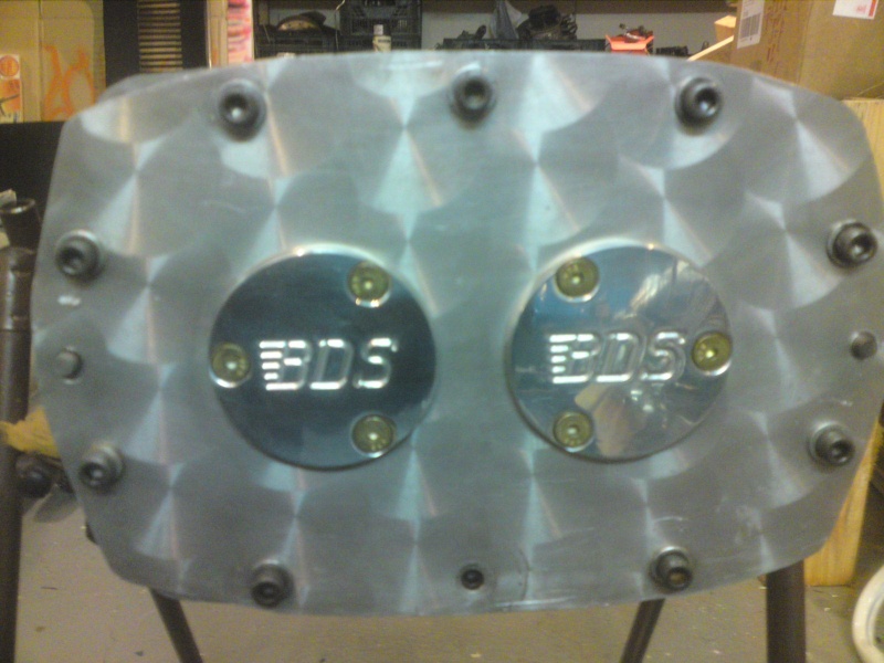

MES ROULEMENTS ET JOINTS SONT ARRIVES DES ETATS UNIS HIER ............
ET COMME UNE BONNE NOUVELLE N'ARRIVE JAMAIS SEULE ..... LA PLAQUE
ARRIERE DU BLOWER PARTIE AU SURFACAGE M'A ETEE RENDUE CE MATIN
JE MONTE LES NOUVEAUX ROULEMENTS ET LES JOINT SPI
<<<<<<< LES PIONTS DE CENTRAGE SONT REMONTES A LEUR TOUR ........>>>>>
LES PALES DU BLOWER SONT NETTOYEES ET CELLE QUI ETAIT UN PEU RAYEE EST
LEGEREMENT RESURFACEE .............
LE TOUR DU "CASE" DU BLOWER EST ENDUIT DE PATE A JOINT ........... IL
NE FAUT PAS METTRE DE JOINT PAPIER A CET ENDROIT POUR GARDER LA MARGE LA
PLUS SERRER POSSIBLE AVEC LES PALES DU BLOWER (2/10 mm) SUFFISE
<<<<< LA
PLAQUE ARRIERE EST MAINTENANT REMONTEE EN DOUCEUR ET FAISANT TOURNER LES
PALES POUR NE PAS ABIMER LES LEVRES DES JOINTS SPI
LA PLAQUE ANTI POUSSIERE VIENT REPRENDRE SA PLACE ........... MAIS
AVANT CA JE LA REPERCE EN SON CENTRE DE DEUX TRIANGLES ................
......... OU JE VAIS VENIR FIXER DEUX LOGOS DE LA MARQUE ......... ET
QUI PAR LEUR APPUIS VIENNENT TERMINER L'ETANCHEITE A L'ARRIERE DES
ROULEMENTS EN FIN D'AXE DES PALES

<<<<<< COMME LE COMPRESSEUR TIENS LA CHARGE EN AIR ET QUE TOUS LES CYLINDRES SONT OK .......... JE REDEMONTE LE BLOWER POUR POUVOIR INSTALLER LA NOUVELLE TUYAUTERIE POUR L'INJECTION D'EAU ......>>>>>
<<<<<< LE PASSAGE EST ASSEZ ETROIT MAIS C'EST LE SEUL MOYEN DE FAIRE ..........>>>>>>
<<<<< LES TUYAUX SONT ENSUITE PASSES DANS UN BOUT DE GAINE EN AMIANTE POUR PROTEGER LES PARTIES QUI POURRAIS TOUCHER LE BLOWER QUI LUI EST QUAND MEME TRES CHAUD QUAND IL TOURNE ........MEME SI CES TUBES SONT EN SILICONE ........>>>>>>>

ET MAINTENANT LA PHASE DE REMONTAGE DU HAUT MOTEUR ............. EN IMAGES ET MUSIQUE S'IL VOUS PLAIT !!!!!!!!!!!!!
